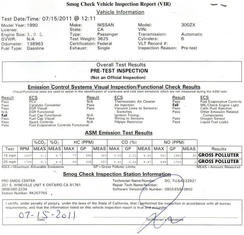

I'll let the attached pic speak for itself. The smog tech said he'd start at the ECU considering the level of gas the thing is burning. If it passes, check everything else:
